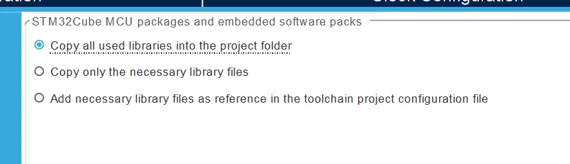

I am trying to integrate CMSIS-DSP in my CMake project. From CubeMX, I have the following options:

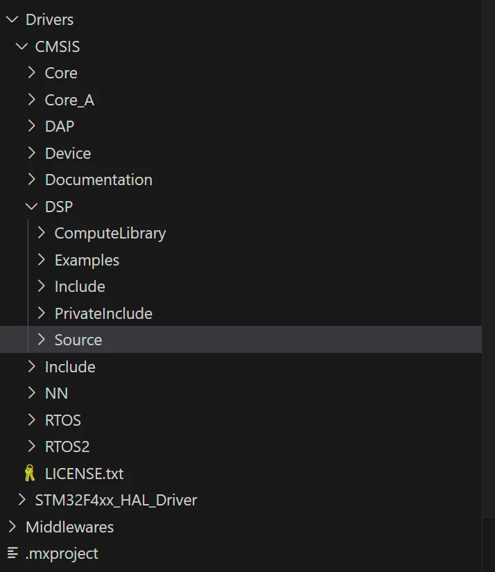

and I see the following folder struct:
and to include DSP folder in my project, I have done the following changes in my top level CMakeLists.txt

Question is, am I configuring anything wrong in CubeMX? From where should I bring configDSP and configLib?

I suspect STM32CubeMX is probably giving you Drivers/CMSIS/DSP/Source/configDsp.cmake, but if not, you can find that here:
STM32CubeF4/Drivers/CMSIS/DSP at v1.28.2 · STMicroelectronics/STM32CubeF4
Seems somethings got lost in migration. You should find the missing files here:
CMSIS_5/CMSIS/DSP at 5.9.0 · ARM-software/CMSIS_5
such as
Drivers/CMSIS/DSP/configCore.cmake
Drivers/CMSIS/DSP/configLib.cmake
Drivers/CMSIS/DSP/Toolchain/*.cmake
I believe you'll need to set() the variables that they and the CMakeLists.txt files need (e.g. in your CMakeLists.txt), something like
set(PROJECTNAME CMSISDSP)
set(ROOT "${CMAKE_CURRENT_LIST_DIR}/Drivers")
set(ARM_CPU cortex-m4)
# set only ONE of these, according to your compiler
set(GCC 1)
set(ARMAC5 1)
set(ARMAC6 1)
set(ICCARM 1)
before you
add_subdirectory(Drivers/CMSIS/DSP/Source)
See Drivers/CMSIS/DSP/Source/CMakeLists.txt and the *.cmake files for the variables they consume/expect.

Another approach I've had luck with is to add the CMSIS-DSP packs as software packs (CMSIS-Pack) in STM32CubeMX. Here are the directions:
  1. Get both the CMSIS Core and the CMSIS-DSP packs.
    1. I'd recommend downloading the Core pack from https://www.keil.arm.com/packs/cmsis-arm/overview/ and the DSP pack from https://www.keil.arm.com/packs/cmsis-dsp-arm/versions/.
  2. Add the packs as per UM1718 § 3.4.5.
    1. If downloaded as recommended in step 1.a., install "From local".
  3. Select and enable the new software component as per UM1718 § 10.
  4. Generate code as normal
    1. Well, almost "as normal." For me this does not work with "Copy only the necessary library files" in the code generator section - instead I choose "copy all files" or "copy references" instead (ref UM1718 § 4.11.2), which seems to work fine.
  5. Open and make generated CMake project as normal - the CMakeLists.txt works fine as generated.
  6. Edit code and build.
