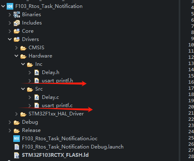

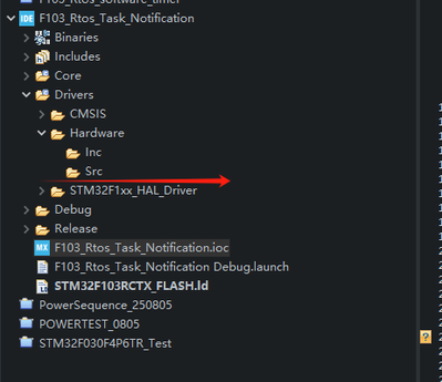

         After I use STM32CUBEIDE's built-in STM32CUBEMX to generate code, the source files and header files under the folder I created myself disappeared, how can this be solved?
        Before I use STM32CUBEIDE's built-in STM32CUBEMX to generate code:
      After I use STM32CUBEIDE's built-in STM32CUBEMX to generate code,all the files I created disappeared.

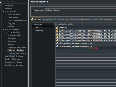

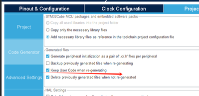

     The compilation path of the file I created has already been saved, and I also checked the keep user code when re-generating option

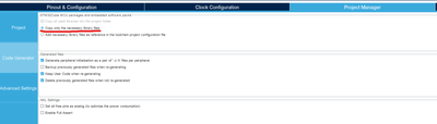

Could you please check the copy only the necessary files, this is will keep your custom files.
KR,
Souhaib
I checked this option and changed it to the next option, but the problem persists

The dedicated team are already aware of this issue (Internal Ticket number 196837), and fix will be implemented soon. In meantime, I recommend not placing your folder inside any CubeMX-generated directories (Drivers, Core, Middleware). Instead, please place it directly under the project root.
