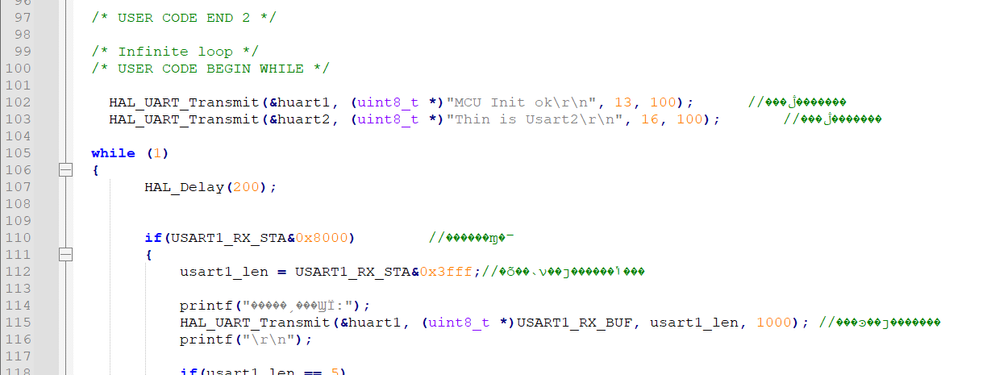

STM32CubeMX v6.15 only supports UTF-8 encoding of generated files?
小大柱子
When upgrading to versions 6.13 and 6.14, regenerating the project would force the file encoding to UTF-8, causing garbled Chinese comments. However, adding a line -Dfile.encoding=GBK in the STM32CubeMX.l4j.ini file under the installation folder could solve the problem. But after upgrading to version 6.15, this command seems to have become ineffective. Even if the system variable is added, the regenerated code will still be forced to UTF-8 encoding. Using UTF-8 is rather troublesome. Does anyone know how to change it to GBK encoding?image.png
Hello @小大柱子 ,
Thank you for bringing this issue to our attention.
The issue is raised to the dedicated team under this internal ticket (Ticket Number: 214028).
Thanks.
Mahmoud
