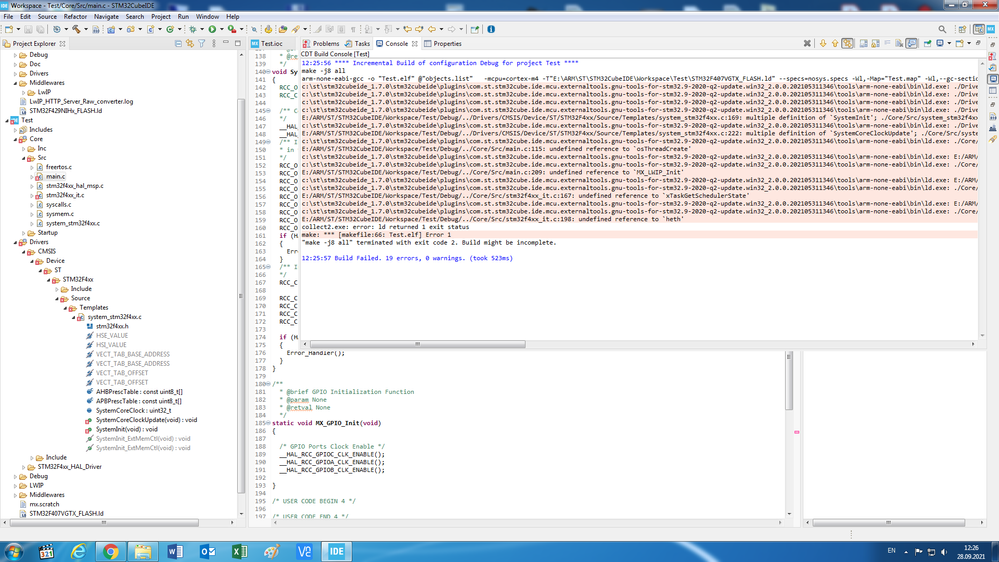

Time to time cubeMX configurator includes c files in multiples, which I can clear by deleting one of them. But cubeMX insists adding multiples again in each regeneration. In freshly generated projects it doesn't do so. That issue appears only when I attempt to make a revision using the cubeMX configurator.
I am using cube IDE version 1.4.2 and :
cube MX
Version: 6.0.1-RC3
Build: 20200810-1643 (UTC)
In the attached image you can see multiple includes of system_STM32F1xx.c file. Project builds smoothly when I delete one of them.

Thanks for your attention prain. No, the code has been generated using cube IDE. Newly created projects do not have such a problem. After several editions and modifications using cubeMX configurator -not stand alone one, this is done under the hood of cube IDE- all of a sudden, it starts to create duplicate files under src, and cmsis/template folders.
I still have this phenomena, but I learned to survive by deleting one of the multiples. Until I discovered where to find the the multiples, I had been regenerating the complete project from scratch, which was a painful task.

No, this issue has not been resolved since then. There have been many OS updates and cubeMX updates since that inquiry.
I thought this a problem no one else encountered. Nobody from ST Support team paid attention too, despite my repeated inquiries.
Problem does not happen with freshly created projects, but after repeated reconfigurations using cubeMX under CubeIDE.
So I have been surviving by deleting the duplicate file in drivers/CMSIS/Device/ST/STM32F1xx/source/Templates/ folder. (In case of system_stm32f1xx.c file, but it happens in other CPU types, also.)
