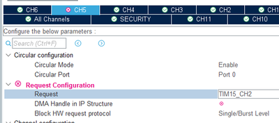

I have been working on an application with multiple DMA channels and timers.  For some reason, STM32CubeMX doesn't have the proper drop-down options for TIM15_CH2 in the DMA channel configuration. All the other timers and channels appear to configure properly:

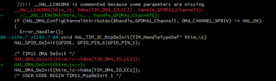

Here is the generated code.  My fix/workaround is shown in RED, while the code generated by STM32CubeMX is in GREEN:
Luckily, we do have the work-around, but the problem has become relatively annoying.  Thank you in advance.

Could you please add your .ioc file (based on the STM32CubeMX V6.14.1) so we can reproduce this on our side.

Thank you, @STTwo-32 .  Please find an example IOC file that has the issue.
STTwo-32
Hello @rbtmkr42
Thank you so much for your collaboration. I've escalated this behavior to the concerned team for correction on the future (under internal ticket number 209178).
PS: this has been solved on the version 6.15.0 of the STM32CubeMX.
Best Regards.
