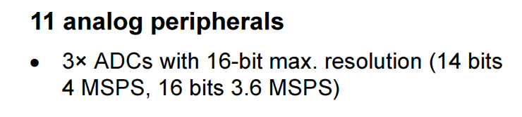

+ some have 16 b converters... i have here stm32H743 ->
