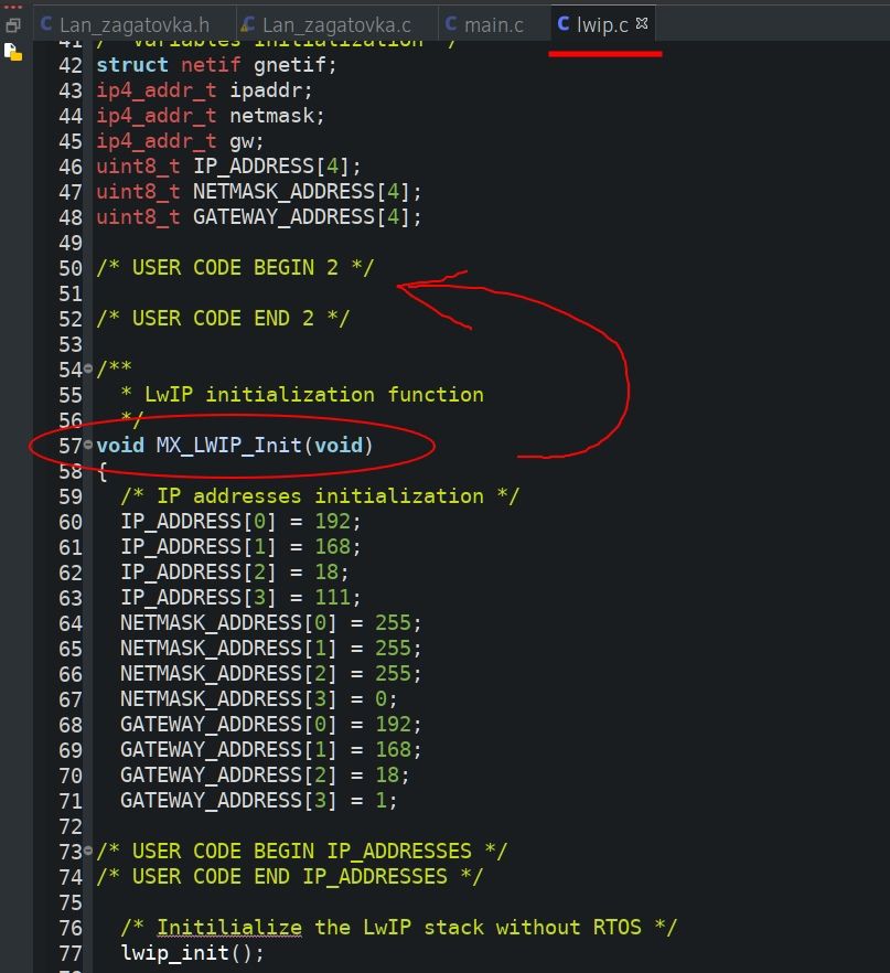

0693W00000VOmcyQAD.jpgHow to correct to deinit a some built-in functions and, after my edits, initialize it again?
For example, on this function "void MX_LWIP_Init(void)".

You don't need to deinitialize the whole IP stack to change MAC, IP addresses and even network interfaces and similar parameters.
Some examples:
https://community.st.com/s/question/0D53W00000zHH9PSAW/changing-ip-address-mac-address-during-runtime
