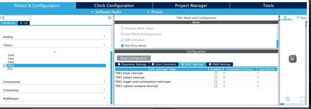

chriskuku
chriskukuAuthor
Senior II
November 29, 2022
Maybe I forgot to tic the Interrupt check box in the .ioc Timer configuration, since I didn't see an interrupt in the source file.
What is the interrupt that is fired, when the timer reaches 65536 (overflow). Is it the Tim1_BREAK interrupt? Or is it the Capture_Compare Interrupt?

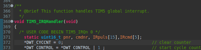

AScha.3
December 17, 2022
set int active in Cube, [gen.code] , then see timer int in stm...xx_it.c file .
ex:
0693W00000WLEjPQAX.pngthen see in xx_it.c :

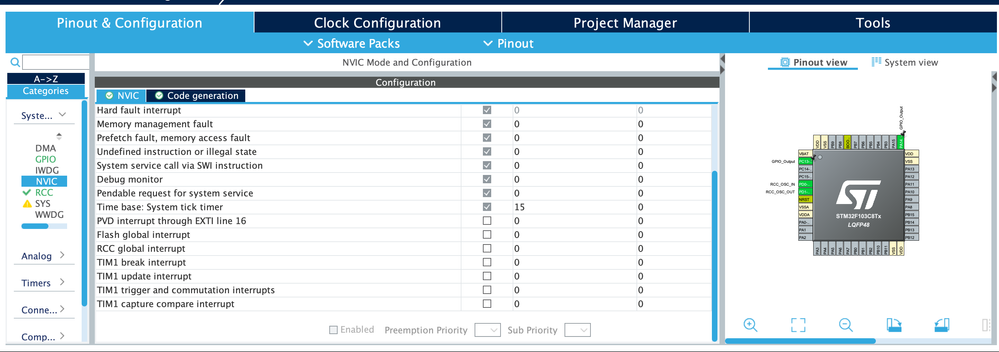

0693W00000WLElLQAX.png0693W00000WLEl6QAH.pngThanks.
I'm using TIM1. I don't see global interrupt. Also, why DMA2 stream0 global interrupt? I don't use DMA. Furthermore this is an STM32F103 (blue pill) and it doesn't have a TIM5.
AScha.3
December 17, 2022
hey, this was just example (from my H743 ), to show you , how to do.
you need click on the int you want to enable them !!!! x = enabled !
then : gen. -> get int in xxxit.c
