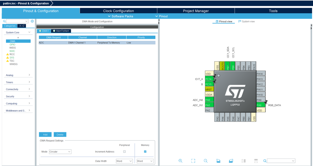

If I, call "HAL_ADC_Start_DMA();" outside of while loop, it's not working. If I, call it inside the while loop, it's working.
vijay_66
Issue in starting multichannel ADC through DMA

hadc.Init.DMAContinuousRequests = DISABLE;
is wrong, must be enabled.
hth
KnarfB
5 REPLIES 5
KnarfB
Principal III
hth
KnarfB
LCE
Principal II
First of all, please use the "</>" button to post your source code.
Then, what KnarfB said, and have you set the DMA to CIRCULAR? Or doesn't this STM have this DMA feature?

	HAL_ADC_Start_DMA(&hadc, value, 2);

	hadc.Init.ContinuousConvMode = ENABLE;
	hadc.Init.DiscontinuousConvMode = DISABLE;
	hadc.Init.ExternalTrigConvEdge = ADC_EXTERNALTRIGCONVEDGE_NONE;
	hadc.Init.ExternalTrigConv = ADC_SOFTWARE_START;
	hadc.Init.DMAContinuousRequests = ENABLE;
	hadc.Init.EOCSelection = ADC_EOC_SINGLE_CONV;

static void MX_DMA_Init(void) {
	/* DMA controller clock enable */
	__HAL_RCC_DMA1_CLK_ENABLE();
	/* DMA interrupt init */
	/* DMA1_Channel1_IRQn interrupt configuration */
	HAL_NVIC_SetPriority(DMA1_Channel1_IRQn, 0, 0);
	HAL_NVIC_EnableIRQ(DMA1_Channel1_IRQn);

Thank you for your feedback and it worked.
