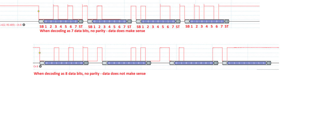

I am passing an array of uint8_t values. Only 4 bytes. The bytes are getting transmitted via the TX pin as expected, but only 7 bits per byte are transmitted. (see tx_8_bits_no_parity image).

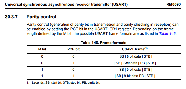

So I got into the F429xx datasheet (
) and on page 994 the Table 146 clearly states that when the bits M (length = 8bits) and PCE (parity = None) are reset, the UART frame will be: Start Bit, 8 data bits, Stop Bit.Why is MCU sending only 7 bits when no parity is enabled? So I decided to enable parity in CubeMX and set it to Even.
However, the parity bit just takes up one of the 8 bits, making the data only 6 bits! (see tx_8_bits_even_parity image).
The same table 146, clearly states that the MCU should be sending 7 Data bits and not 6.
How can this be? Am I missing something? I am only trying to send 8 bits of data (0x00 - 0xFF) without parity.

That decoder was written by somebody who does not quite understand how UART works.
The stopbit is transmitted as a whole bit, but it is received by sampling it in its middle (usually with the 3x oversampling). Start bit falling edge detection commences immediately after that. The consequence is, that even if the transmitter's actual bit time is slightly above the receiver's (here: your 'detector''s) expected bit time, the receiver still works flawlessly.

‎2017-08-01 3:15 AM
It's your decoding (program? scope? LA?) which is flawed, not the UART. There are clearly 1 start bit, 8 data bits and 1 stop bit on the tx_8_bits_no_parity.PNG

‎2017-08-01 6:03 AM
Brought my Paint skills into action.
Data transmitted is (decimal):
[0] = 36
[1] = 2
[2] = 49
[3] = counter, 0 - 255. Due to being only 7 bits, rolls over at 127, but in the software the counter keep going until 255.
The only way I can decode the data if I remove the Stop bit from the decoder's configuration and set data length to 8 bits. Then it works fine.
However, my USART2 peripheral configuration does contain a 1 Stop bit.
‎2017-08-01 6:11 AM
Stop bit is high.
There is no reason to wait after stop bit, the next start bit proceeds immediately.

I tested it on my 429disco board and Teraterm.
take a look at this figure from RM .(M=0 means 8N1)
So .. There is not any error.. Check the polarity of stop bit..
Waclawek.Jan
‌ has right.Check your Logic analyser or capture equipment you use.
