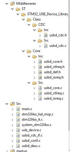

the Cube MX Version 4.22.0 don't generate the Middleware/ST correct. The folder tree is correct, but not filled with files.
I tested with the L475VGT and add the Virtual Com Port.

Hello
Heil.R
There is an issue with STM32CubeMX v4.22to merge the patch STM32CubeL4 v1.8.1 with existing STM32CubeL4 v1.8.0 source tree.
This issue isalready raised internally.
Try todelete existing STM32CubeL4 v1.8.0 firmware package and re-download/install the patch v1.8.1.

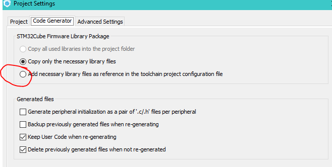

Hello!
In my PC generates all files correct
Maybe you don't have full administrator rights to copy files to your folder.
Posible oolutions.
1. Add middleware as reference only.
2. Try to change the project folder name or/and path, and to take the proper rights to create files inside this folder.

Posted on August 01, 2017 at 12:01
I got full admin rights. and the 'ref' files don't fit it. :|
