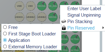

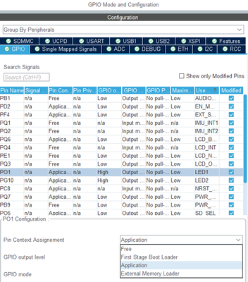

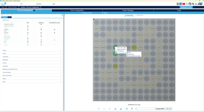

Using latest STM32CubeMX version 6.16.1 on STM32N6570-DK. It is possible to assign peripherals like UART, I2C, etc. into multiple contexts - boot, app, memloader, but I cannot find a way to assign plain simple GPIO's into multiple contexts. CubeMX only allows to pick Free (which means none) or one of them. Needless to say, I would like to use same LEDs and buttons from multiple contexts. I don't think the RIF is the cause, not using it right now. Seems like a missing feature.

I agree with you. It should be possible to assign the same GPIO in multiple contexts, in the same way as on the STM32H7R.
Ticket 224701 has been escalated to dev team to correct this behavior.
