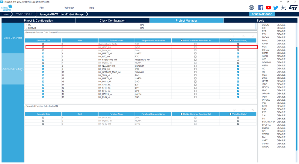

MX_GPIO_Init() is generated but not called in main(). STM32CubeMX6.4.0 with STM32H755XI
‎2022-02-06 7:48 PM
Environment:
tool: STM32CubeMX6.4.0
cpu: STM32H755XI
Repos: STM32Cube_FW_H7_V1.9.1
I configured pins as GPIO input/output by STM32CubeMX GUI. MAX_GPIO_Init() is auto-generated and all pins are configured inside. However it is not called by any function. Usually it will be called in main().
Below is the auto-gernerated main() function code. MAX_GPIO_Init() is missed. Is it a abnormal case?
My ioc file for this case is also attached.
Thanks.

Hello @Lzhou.1​ ,
Thanks for your feedback,
It seems that you checked the " Do not Generate Function Call " in your CubeMX configuration.
Could you please uncheck it and check the visibility field instead, just like the attachment below.
I hope this helps :) !
If your issue is solved, please close this post by clicking the "Select as Best" button. This will help other members of the community find this response more quickly :)

‎2022-02-08 8:37 PM
Yes, it works, thank you very much!
