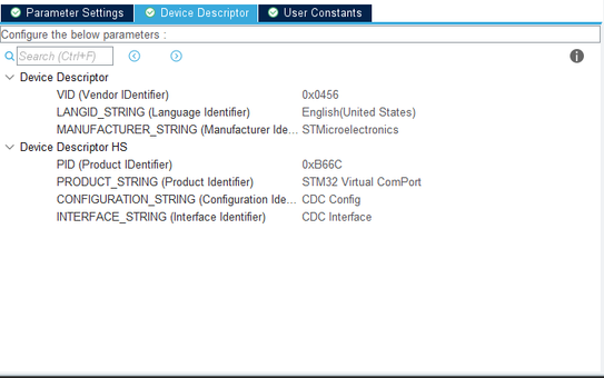

I am working on USB Device Middleware on STM32F469NI using STM32CubeMX. For our use case we have to modify the PRODUCT_STRING descriptor value (default is "STM32 Virtual ComPort"). Is it recommended to perform this, or are there any STM standards for these values?

Of course, you can change PRODUCT_STRING descriptor. Only PID and VID are specific identifiers for USB devices, you can request PID in OLS ticket. Are you sure about your VID 0x0456?

Kindly ignore the modification to that VID and PID in the screenshot as it is temporarily adjusted for our early-stage development with one of our GUIs. Sure, we will raise an OLS ticket if that modification becomes a long-term requirement.
