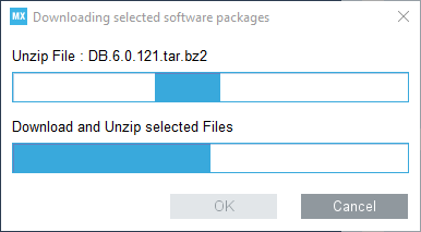

I recently updated my version of CubeMX from 6.12.1 to 6.13.0. It is now unable to open my .ioc for a specific STM32H563VI project.
When I try to migrate, it loads the IOC, then gives an error saying it is "Not a valid ioc file".
If I try to continue using the old version, it gets stuck on unzipping a file (DB.6.0.121.tar.bz2) for a few minutes, then silently stops.
If I uninstall and go back to CubeMX 6.12.1 it can open it no problem, but that doesn't seem like a good solution.
I have tried reinstalling CubeMX 6.13.0 from the website directly, checking for updates and relevant software packages.
I am able to open previous projects that use the same MCU, so it seems it may be due to some specific configuration used. I have tried modifying the working project to include the same features as the non-working one, but it has not prevented it from loading.
I tested opening an older project which used the NUCLEO-H563ZI. This older project also gives an "Not a valid ioc file" error, whether I try to continue or migrate it.
I tried uninstalling STM32CubeMX, STMicroelectronics stlink-server, and STMCUFinder. I then reinstalled STM32CubeMX 6.13.0, waited for it to check for updates, and tried again. Migrating once again gave an invalid IOC error, and continuing with the old version immediately showed the same file being unzipped, until it closed.
There does not appear to be any relevant information in the errata/known limitations of 6.13.0. Any guidance or support would be appreciated!
I have the same problem.
It gets stuck here and, after a few seconds, gives up.

Today I ran into the same issue with an STM32H563. A STM32G4 MCU works without issues, I tried several times to reinstall cube.
When starting an empty project with the STM32H563, saving and loading works. I tried comparing the content of this clean, working file with my old file but didn't found anything helpful.
Any information are much appreciated as this makes CubeMX 6.13. and some new libraries completely unusable for me.

So I resolved my issue by removing the config related to Memory Management in the .IOC file with an editor. In the file that was working fine with CubeMX 6.12.1 but produced the "Not a valid ioc file" error in 6.13.0, there was this section:

When I replaced all the lines by:
MMTAppRegionsCount=0
the file could be migrated & opened successfully within Cube MX 6.13.0.
The issue did also arise with the IOC file that I freshly re-built with 6.13.0. I had everything else configured so far, but when I click on the Memory Management tab and save the IOC file, afterwards it doesn't open but throws the same error.
On the other hand, when I start a fresh IOC file in 6.13.0 with nothing configured and click the Memory Management tab + save the file, the error does not arise.
So my assumption is that if some other part is configured, the Memory Management config corrupts the file. I didn't have the time to check every part I configured to find out what other part causes this error, as for me this solution works because I don't need the Memory Management config.
Let me know if you encountered similar behavior.
