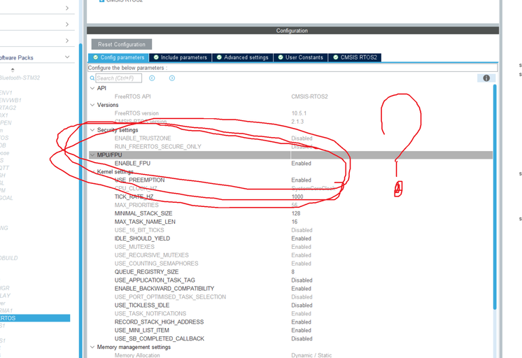

Versions:
STM32CubeMX 6.12.0
FreeRTOS X-Cube-FREERTOS 1.1.10 (FreeRTOS Kernel 10.5.1)
STM32U5 MCU Package 1.6.0
Although STM32CubeMX now has support for FreeRTOS, it does not appear to recognise the FreeRTOS support (https://www.freertos.org/Security/04-FreeRTOS-MPU-memory-protection-unit) for the Cortex-M33 MPU:
It also does not include mpu_wrappers.c, which means I cannot enable configENABLE_MPU in FreeRTOSConfig.h manually without also copying this from the canonical FreeRTOS kernel release.
I have, in fact, manually imported mpu_wrappers.c and turned on configENABLE_MPU. Everything appears to work quite nicely.
Why is this option not supported?
What, if any, dragons have I unearthed by turning it on?
If the there are no dragons, then clearly this is an oversight and should be included in later releases. It adds a frustrating extra step to upgrading FreeRTOS versions with CubeMX.
2024-09-06 6:42 AM
Hello @BCowp.1 ,
Thank you for your feedback
I've reported this request to the CubeMX team ( Internal Ticket: Ticket 190405). I'll keep you updated if there are any updates
2024-12-28 6:34 AM
Hi @Sarra.S , do you have an update on this topic / ticket ?
2025-01-06 6:50 AM
I will keep you updated @clemens!
