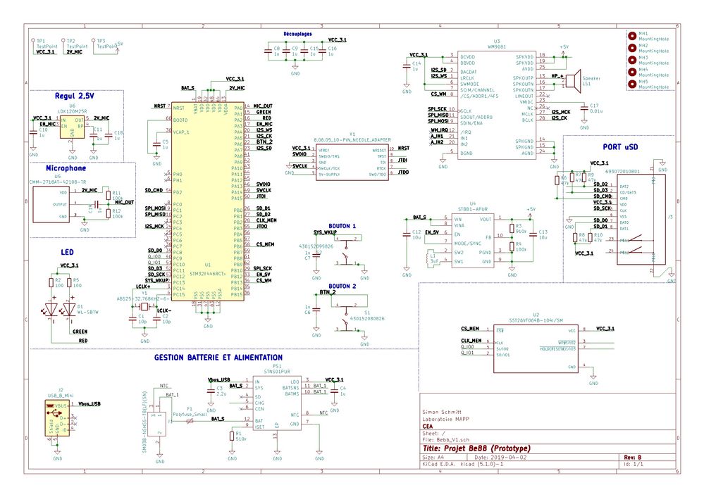

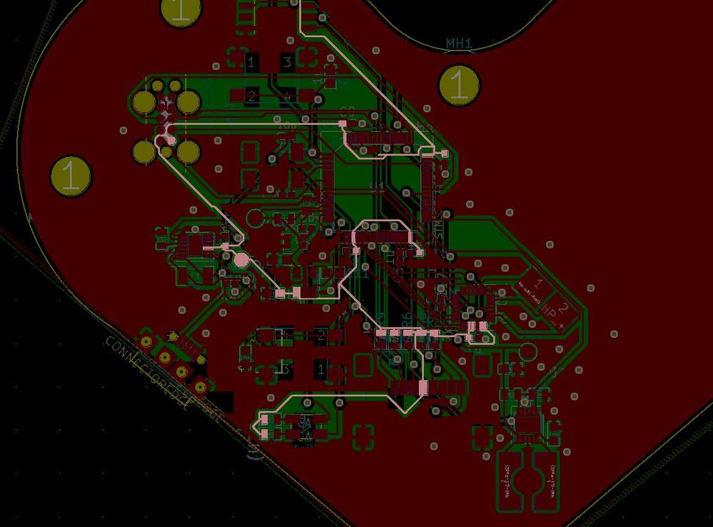

I'm back here due to the same kind of problem...
I've assembled my design with a new board (I corrected some mistakes which don't imply the uC) and now, the J-link can't even find the uC.
Here is the design:
and here is the board:
What you see highlighted is the LDO 3.1V line from an STNS.
What I checked on my board with an oscilloscope is that JTDO is the only signal which don't seem to be properly driven. The signal is very noisy and I can perceive that it try to answer but the noisy signal just have a slightly higher average.
I tried to connect the Needle 10 pins to an ST-link and it don't work either.
If you have an idea...
Thank you.

Well, You should read AN4488...
  • VDDA is unpowered... And no - it's not only for ADC and DAC, but also internal RCs, PLLs, reset circuit and possibly something else.
  • VCAP1 is wrong. It must be 4,7 uF and I suggest it to be at least 10V X7R 1206.
  • VDD capacitors also doesn't follow recommendation - these should be 4,7 uF + 4 * 100 nF. I suggest 4,7 uF to be at least 10V X5R 0805.
  • That long two part supply route is bad. Make a single branch for MCU and put recommended VDD capacitors to it.
