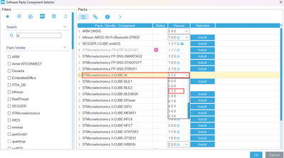

Issue 2: X-CUBE-AI configuration resets when reopening the IOC file
Environment:
  • STM32CubeIDE 2.0.0 (with embedded CubeMX)
  • X-CUBE-AI 5.1.2
Steps to reproduce:
  1. Create a project in standalone STM32CubeMX.
  2. Clear pinouts, configure peripherals, and enable X-CUBE-AI.
  3. Generate the code → Build succeeds.
  4. Close CubeMX and close the entire project.
  5. Open STM32CubeIDE 2.0.0 → open the .ioc file.
Problem:
When opening the IOC inside CubeIDE, the X-CUBE-AI package becomes deinitialized, and:
  • X-CUBE-AI settings are lost
  • The 5.1.2 version selection resets every time
  • Code regeneration requires reconfiguring AI settings again.

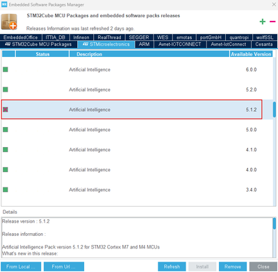

Hello @yaswanth_cdac ,
As Workaround, I recommend that you remove X-CUBE-AI 5.1.2 from the STM32Microelectronics package list reinstall it again and click on Refresh.
Thanks.
Mahmoud
ok,
Thank you, for solving the error in 5.1.2 package of x-cube-ai.
