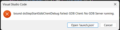

Now running my "DualCore_Debug" compound config throws a gdb server startup issue on the CM4 half of the attach:
With an underlying warning on the CM4_Debug log:
'From Debug Session: step debug conf validation: No image file loaded, see imagesAndSymbols attribute in the debug configuration.'
And the CM7 debugger runs as normal / stops at main, but messes with the dual core startup ASM file timing (stock CM4 domain stop and wait for CM7 configure / continue) so that my application won't initialise correctly, the build is fine, as my app will run in flash / non-debug mode.

Can you please recommend any launch.json changes required to match the patches in 3.7.0?
Or otherwise let me know if it's an issue with the version update, it seems that Ln50 of the launch.json is the source of the issue, gdb no longer being okay with just a symbol file load.

Removing the specific access point in the CM4 seems to fix the debugger stall issue for CM4 (i.e. comment out serverAPID) and allow dual core debugging. The CM4 debug log warning about no images being loaded seems to be a red herring, please advise if there is a way to suppress this (as it will always flag for H7 dual cores). The extension seems to crash on loading ELF images during the CM7 CubeProg run about 20% of the time but I can live with that.
