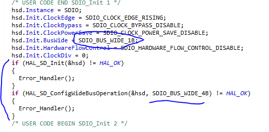

I installed STM32CubeMX version 6.5.0, I generated the code with STM32Cube FW_F4 V1.27.0 I get the following code
_legacyfs_online_stmicro_images_0693W00000dDhI0QAK.pngand it works well and no error in the hardware I checked everything

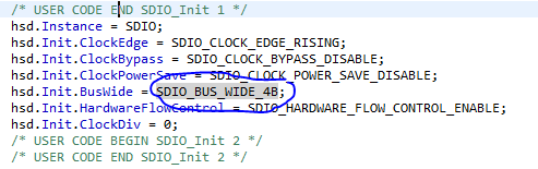

on the other hand with the latest version of STM32CubeMX 6.8.1, I get the following code: and my program crashes
_legacyfs_online_stmicro_images_0693W00000dDhKaQAK.pngSO ?
Is there a bug in STM32Cube_FW_F4_V1.27.1 or in STM32CubeMX for SDIO?
