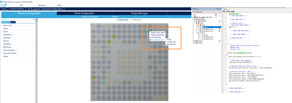

​Hello @Community member​ ,
You're working with a dual core MCU so you need to specify in which context you need this pin.
Right click on pin then under "Pin Reserved" Choose one of the 2 Cortex.

‎2019-09-07 12:58 PM
Thank you so much, Khouloud! This worked for me.
This menu (for selecting Cortex-M4 vs Cortex-M7) is really well hidden!
The menu item name "Pin Reservation" doesn't mean much, so none of the engineers on my team were able to figure out how to get to the context assignment menu.
I wish the interface for selecting M4 vs M7 was designed similar to other peripheral selection, on the left-hand side of the window, where we have checkboxes in two columns: One for M4 and another for M7.

For anyone who also stumbles across this and wonders whether they really need to set each GPIO individually: no, of course not.
You can also change several pins together by:
- switching to the GPIO overview (e.g. A->Z > GPIO or Categories > System Core > GPIO)
- marking the GPIO to be changed in the table Configuration (center column)
- then in the table below (different settings lead to a white field) set the setting for all GPIO via the item Pin Context Assignment
Hope that helps.
