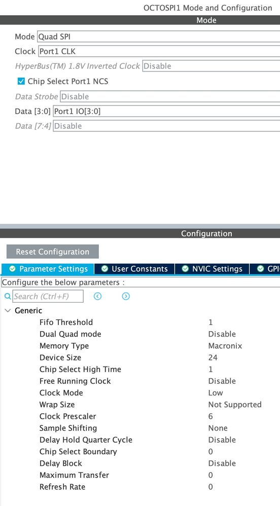

incorrect code generated for OCTOSPI on STM32H725
‎2022-07-08 1:01 PM - last edited on ‎2025-04-23 3:30 AM by Andrew Neil
STM32CubeMX generates incorrect code for the OCTOSPI interface for STM32H725.
The generated code does not populate the Req2AckTime field of the OSPIM_CfgTypeDef structure, but HAL_OSPIM_Config() validates this value and throws an assertion error.
See attached configuration in STM32CubeMX. Generated code is only:
sOspiManagerCfg.ClkPort = 1; sOspiManagerCfg.NCSPort = 1; sOspiManagerCfg.IOLowPort = HAL_OSPIM_IOPORT_1_LOW; // NOTE: MISSING ASSIGNMENT TO sOspiManagerCfg.Req2AckTime if (HAL_OSPIM_Config(&hospi1, &sOspiManagerCfg, HAL_OSPI_TIMEOUT_DEFAULT_VALUE) != HAL_OK) { Error_Handler(); }

Hello Semer,
Thank you for your reply. Your code will build without any errors, and no errors will be reported at runtime unless you compile with the "Enable Full Assert" option checked in STM32CubeMX (Project Manager-->Code Generator-->HAL Settings-->Enable Full Assert)
Can you inspect the contents of your MX_OCTOSPI1_Init() function and report on whether an assignment to sOspiManagerCfg.Req2AckTime is performed? For example, I had to add this line manually:
sOspiManagerCfg.Req2AckTime = 1
Can you then check the implementation of HAL_OSPIM_Config() and verify that an assertion check is made on proper assignment to Req2AckTime. For example, in the latest HAL (1.11.0) I see:
HAL_StatusTypeDef HAL_OSPIM_Config(OSPI_HandleTypeDef *hospi, OSPIM_CfgTypeDef *cfg, uint32_t Timeout)
assert_param(IS_OSPIM_REQ2ACKTIME(cfg->Req2AckTime));
I hope you can see that with the assert_param() statement as shown above, and failure to initialize Req2AckTime in MX_OCTOSPI1_Init() that an assertion failure will be triggered.

‎2022-08-01 4:11 PM
Consider what (0 - 1U) computes to
Consider further QuadSPI usage on OSPIM
OSPIM_Cfg_Struct.DQSPort = 0 will assert
OSPIM_Cfg_Struct.IOHighPort = 0 will assert
