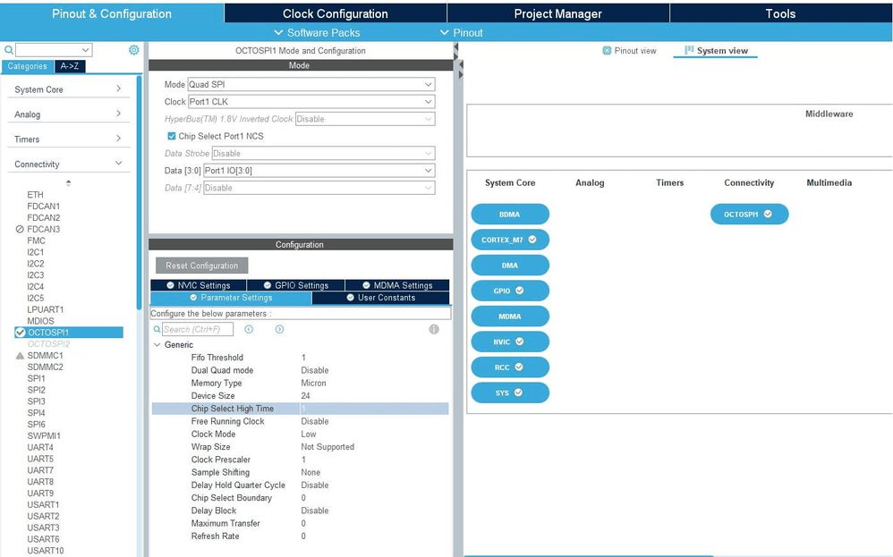

Hello, I have a very basic setup of OSPI1 on STM32H730VBT and I am trying to read the 1st Status Register of the Winbond W25Q128JV.

A custom board with STM32H730VBT and Winbond W25Q128JV connected via OSPI1.

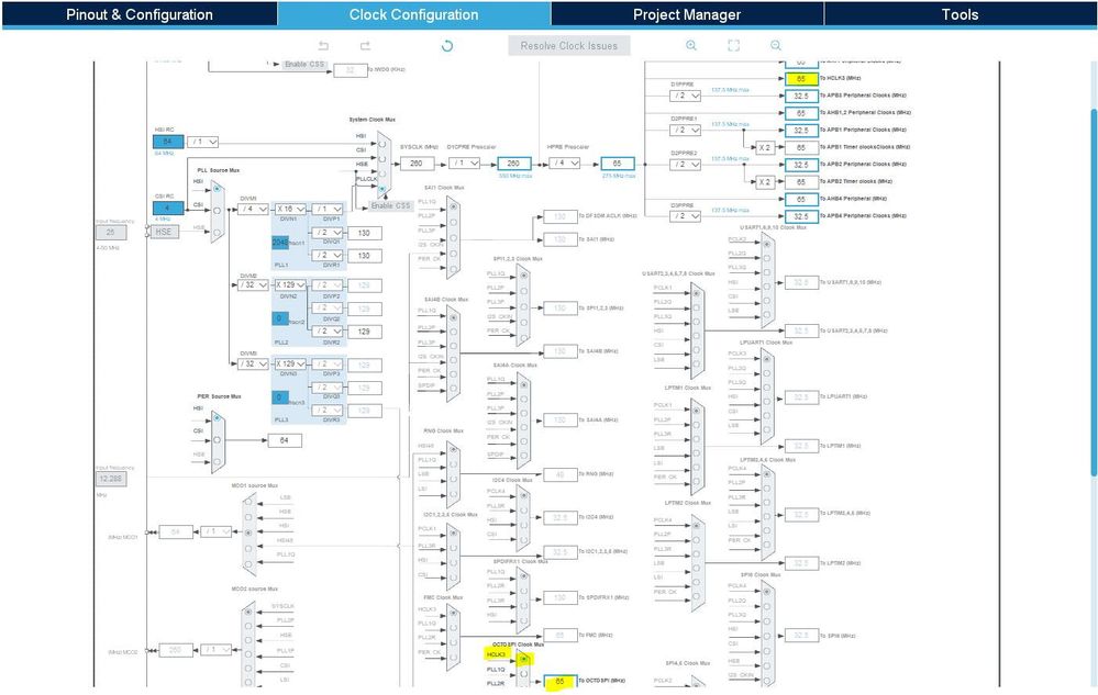

  hospi1.Init.ClockPrescaler = 1; /* HCLK3 is already 65MHz */

  • Missing CLK on PB2
  • Not HAL errors
  • The SR1 read as `0x00`
Expected
  • PB2 CLK signal
  • Non zero SR1
Everything works perfectly when using QSPI on STM32H750 (same board, same clock configuration output [doesn't exceed < Max 133MHz for O/QSPI]). However, when Octo-SPI (OSPI) is used, then nothing is being read. It looks like the CLK signal is not present.
Any ideas what can be tried out?

hospi1.Init.ClockPrescaler = 4;
The HCLK3 used as OSPI clock source is already 65MHz which is already within propose frequency range.

GCern.1
@Andreas Bolsch​, @Community member​, thank you for the assistance. The issue turned out to be the clock.
