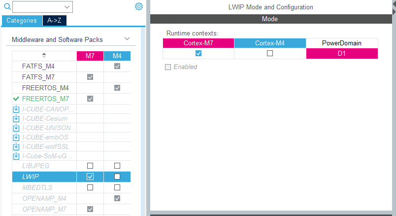

I am testing LTE modem with a STM32H747 MCU
LTE modem is connectied with STM32H747 thru USART2.
I want to use PPP communications with LTE modem.
but when I try to check LWIP in [Pinout & Configuration] of IOC file,
I can't set [Enabled] of [LWIP Mode and Configuration]
It is disabled. I dont know why.

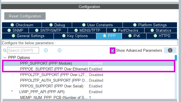

Hello @Son, Dong-Seong​ ,
-> I can't set [Enabled] of [LWIP Mode and Configuration] It is disabled. I dont know why.
I recommend you to follow properly the steps as described in this FAQ.
-> Can you explain how to set PPP with IOC file
- Use PPP_SUPPORT requires PPPOS_SUPPORT, PPPOE_SUPPORT or PPPOL2TP_SUPPORT turned on.
- PPP_SUPPORT needs also PPP_IPV4_SUPPORT and/or PPP_IPV6_SUPPORT turned on.
For that, please refer to the below figure.

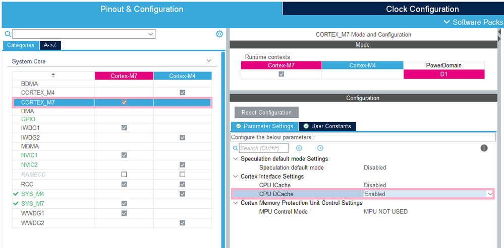

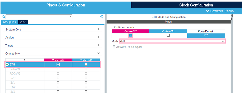

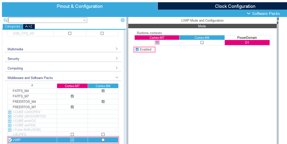

Hi @SOn, Dong-Seong​ ,
Thank you for this clarification.
1- Configure the ethernet as shown in the below figure ( RMII mode for example)
2- Enable the DCache
3- Enable LWIP

‎2023-04-11 4:42 AM
Hi
If I can't set ETH of connectivity, can I not use PPP?
ETH cannot be set because many pins of the STM32H747 are used for other purposes.
Are there any other ways to use PPP?
Thank you.
‎2023-04-11 5:32 AM
Hi @Son, Dong-Seong​ ,
You can enable LWIP only if ETH IP is configured.
Thank you.
