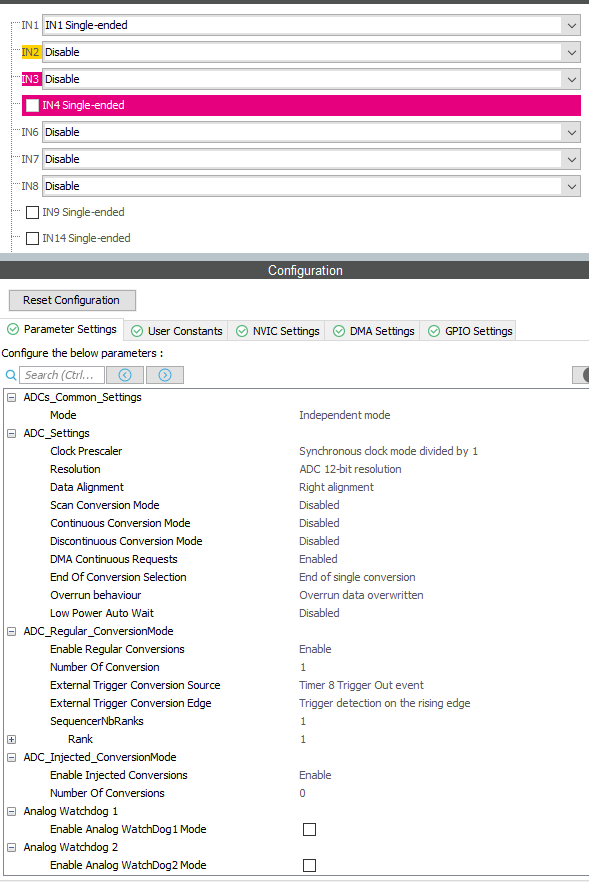

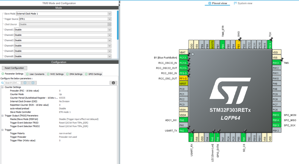

I'm trying to trigger ADC on the STM32F303RE Nucleo board with an external clock generator. Without external trigger settings, it works. I changed the trigger source to Timer8, then in TIM8 settings, I chose External Clock Source. What am I doing wrong? I didn't change any user codes, should I add pin up/down commands to start ADC in user code sections?
My ADC(DMA) and TIM8 settings:
(My clock(square wave) generator connected to PB6 pin)

If the goal is to trigger an ADC sample conversion, the ADC uses the internal clock AND a GPIO as triggering a conversion which is fed by the external clock.
Use a DMA to store the ADC results into a cyclic RAM array so you can see easily what's happening with less SW coding.
‎2023-02-19 8:22 PM
I save the data to a size of 12000 buffer, then write in serial port. Without external trigger settings, it works. But, when I change "Continous Conversion Mode-Disable, External Trigger Source-Timer8", it doesn't work.
Briefly, the code I use(some of the variables are for saving to an SD card):
