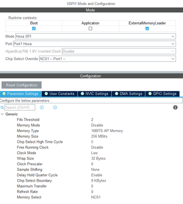

Using STM32H7R3L8HxH with external Flash and PSRAM. STM32CubeIDE version is 1.19.0 MxCube version is 6.15.0.
MX XSPI1 and XSPI2 initialization functions do not set sXspiManagerCfg.Req2AckTime value. Here is XSPI1 code:

Req2AckTime remains zero. Call of HAL_XSPIM_Config stucks in assert on line 15 in this snippet because it expects value to be greater than zero.
HAL_StatusTypeDef HAL_XSPIM_Config(XSPI_HandleTypeDef *const hxspi, XSPIM_CfgTypeDef *const pCfg, uint32_t Timeout)
  HAL_StatusTypeDef status = HAL_OK;
  uint8_t index;
  uint8_t xspi_enabled = 0U;
  XSPIM_CfgTypeDef IOM_cfg[XSPI_NB_INSTANCE] = {0};
  /* Prevent unused argument(s) compilation warning */
  UNUSED(Timeout);
  /* Check the parameters of the XSPI IO Manager configuration structure */
  assert_param(IS_XSPIM_NCS_OVR(pCfg->nCSOverride));
  assert_param(IS_XSPIM_IO_PORT(pCfg->IOPort));
  assert_param(IS_XSPIM_REQ2ACKTIME(pCfg->Req2AckTime));
Workaround is to set the value in the user code section after the sXspiManagerCfg declaration, but it would be nice if this value is configurable in the GUI and generated nicely.

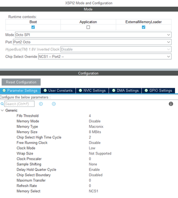

GUI views of XSPI1 and 2 are:
I found several similar forum posts but they seem to blame the clock and multiplexing. But I don't see how that could explain uninitialized variable. HAL_XSPIM_Config isn't generated code, it's static. It must get valid input. So it does look like code generator bug.
