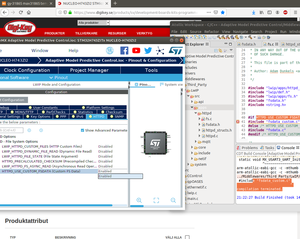

Hi!
I trying to follow this manual to set upp a HTTPD web server in STM32 Nucleo H7 board. But I got a issue because fsdata_custom.c is missing and it seems that I cannot set HTTPD_USE_CUSTOM_FSDATA to false neither. Is this a bug in CubeMX?
How can I solve it? I posted a screen shot and it will give you all the information about my board I'm using.

‎2019-10-26 2:51 PM
See p.8 about the fsdata.c file.
‎2019-10-27 4:57 AM
That's about file fsdata.c, not fsdata_custom.c
STM32MP257FAK3 custom board with STM64-OS as operating system: https://github.com/DanielMartensson/STM64-Computer
‎2019-10-27 6:48 AM
Just change the filename in either place.

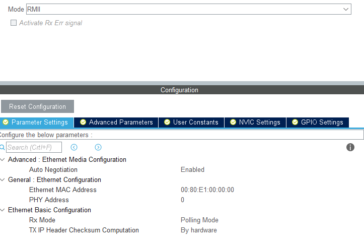

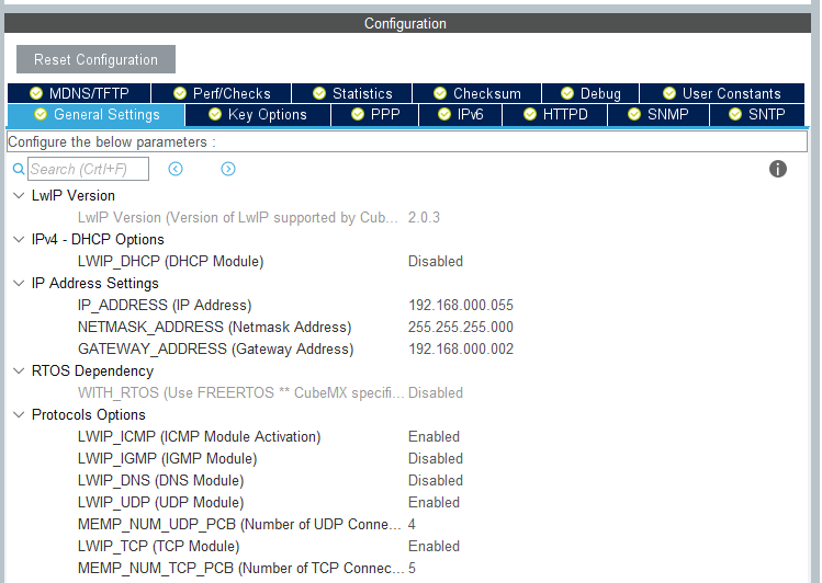

‎2020-10-18 12:45 PM
Hello!
I'm also trying to get a simple ping answer from my STM32F767 according to start point pdf description. But with no results.
Could you please help me a little bit to understand the issue I have?
I have connected my custom board with LAN8742a with a Ethernet cable directly to my PC and just try to ping the Board.
I have disabled to whole HTTPD option, so I don't care abot the missing files for now.
My settings for the ETH are:
Nothing change for the PHY settings (default LAN8742a) and the interrupts are enabled. GPIOs are double checked.
My settings for the LwIP are:And here is my main:
