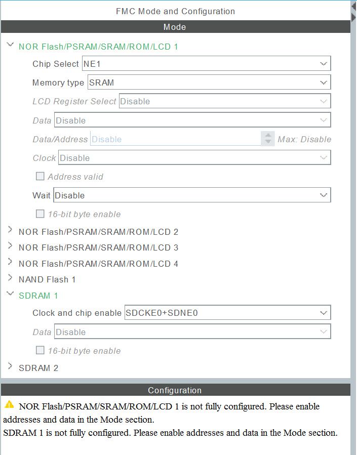

I am unable to configure FMC with SDRAM in latest STM32CubeIDE 1.6.1.
Regardless of what I chose in the Mode section. Can someone guide me, what settings I have to perform?
As stated in the datasheet , the SDRAM1 is only available for H725A.. and H725I.. ( 179 and 176 pin packages )
SDRAM2 being available only for H725I.K ( UFBGA176 package )
Please refer to DS13311 Rev 2 / table "Table 2. STM32H725xE/G features and peripheral counts"

You didn't indicate which MCU part number you are using?
STM32
TRadd.1
It is a STM32H725.
mƎALLEm
and which package?
TRadd.1
It is LQFP 144 (STM32H725ZGT6).
