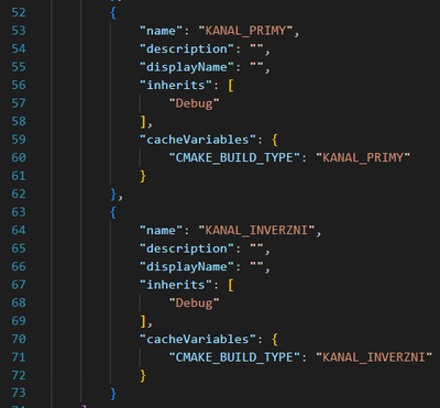

Issue: I'm using two Configurations in CMake -> Configure. Configurations are defined in CMakePresets.json like this:
I'm using define as this:
I'm switching configuration via CMake->Configure->Select Configure Preset.

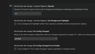

I have set the setting on v1.0.4 as such:
Opacity is 0.5. If I change the Configuration, the Opacity no longer works on the code segment:
But, if I go to settings and just enter the value 0.5, it starts working again, untill the next Configure change.
