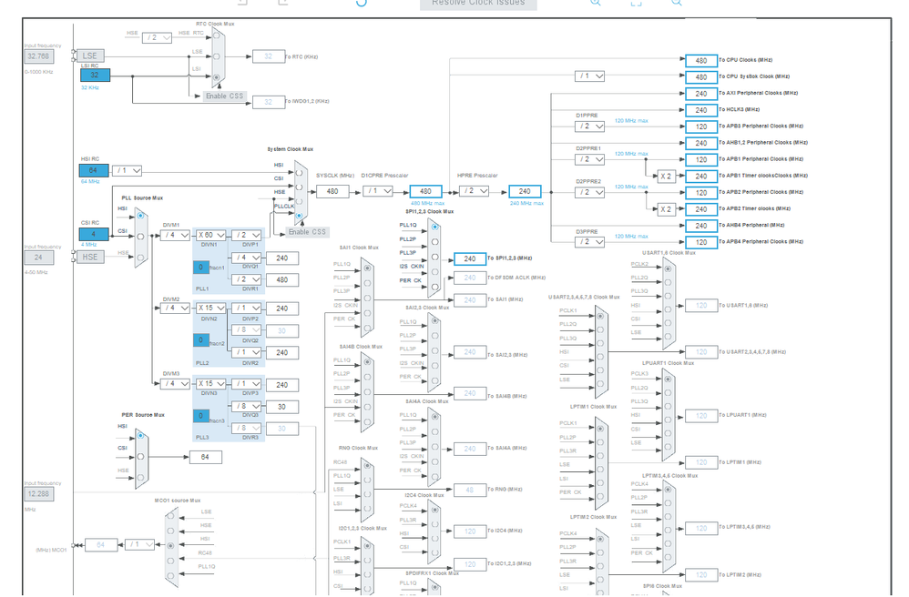

The project is a small color display with touch, where I run with TouchGFX a demo on with several pictures. The interface is RGB, for the rest there is an external Flash where the code is executed from. This project works fine till change over to CubeMX6.2.1, no picture anymore, seems like dead.
The project has a multi boatloader with it's own .ioc file. And a main project wit it's own .ioc file. It is the Multibootloader project .ioc file where the clock setting issue is reported. Not sure if this is the root cause of the issue.

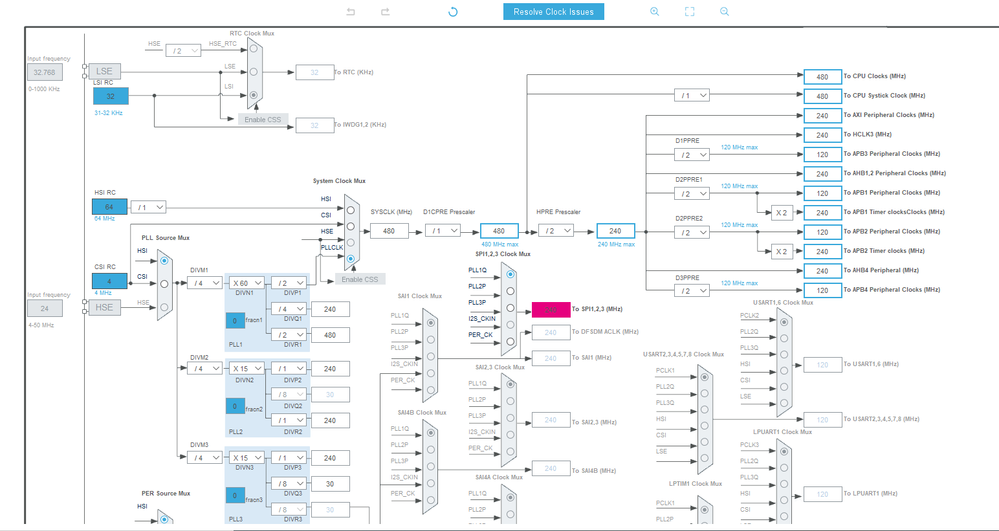

I added screenshots of the Clock Config when using CubeMC6.1.1 and 6.2.1. Both opening the same project, nothing changed in code nor settings. You can see the SPI clock of 240 MHz seems to give an issue. Prescaler of both has not been changed and set at 4. When I solve the issue by changing the PLL divider or using other clock like PER_CK, I can generate code, build the project, but my project does not work at all.

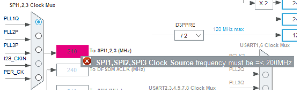

Hover over the error to find the cause. In this case, most likely:
To fix, change the PLL1Q clock to 200 MHz or under, or choose a different clock for SPI that satisfies the restriction.
‎2021-06-21 03:21 AM
Thanks for your fast answer. I did adapt already as you described, strange however I do not get this error with version 6.1.1.
