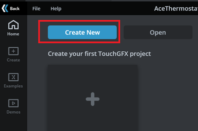

The real problem is that, even though the project that touchGFX creates builds, just for testing I copied the .ioc file to create a new project (not manually, but with cubeMX feature shown below)
But I am still getting the overflowed error, and this should be exactly the same project as the original .ioc creates right? So why does just one build. Can anyone tell me what is happening, tbh I'm freaking out a little bit.

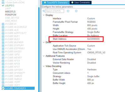

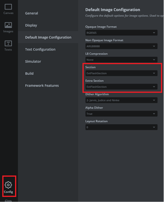

Seems the touchgfx stuff are not relocated to external memories:
For frame buffer needs to be relocated to the SDRAM and the images to be located to the octospi in the case of your board.

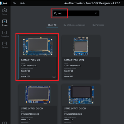

‎2024-04-11 2:56 AM - edited ‎2024-04-11 2:56 AM
If I understand well, you're a newbie with TouchGFX. So I suggest you to start with a predefined board from TouchGFX designer as you are using H735G DK board. Starting from CubeMx is a bit complex and needs a knowledge to configure all the needed stuff CTOSPI interface, SDRAM, Framebuffer, LCD configuration etc ..:

To relocate the TouchGFX assets in external Flash memory:
To set the SDRAM address for TouchGFX:
‎2024-04-11 3:57 AM
