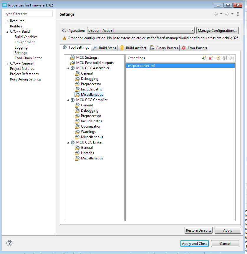

Guys, look carefully at the error - the instruction has an option "0xF". That is only supported in full ARM instruction set, but not in Thumb mode on Cortex-M3. The compiler is missing -mcpu=cortex-m3 parameter.
https://lmgtfy.com/?q=Error%3A+selected+processor+does+not+support+%60dsb+0xF%27+in+Thumb+mode
https://stackoverflow.com/a/39792354
hello Piranha , where to add  -mcpu=cortex-m3  parameter in Cube IDE ?
thanks
Hi, I had the same error, and found out you can add the "-mcpu=cortex-m4" flag in the "Miscellaneous" tab :0693W00000BZrtmQAD.png
