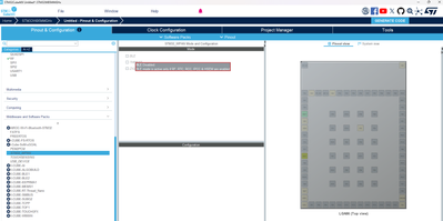

Dear STMicroelectronics Support Team,
I hope this message finds you well.
I am currently working with an STM32WB series microcontroller and using STM32CubeMX (version [insert version number]) for configuration.
While setting up the project, I noticed that the STM32_WPAN middleware component is grayed out and cannot be selected or enabled.
I have verified that the correct MCU/board is chosen and that the project is properly configured for wireless features. However, the WPAN stack remains unavailable in the MX configuration interface.
Details:
  • MCU/Board: STM32WB5MMGHx
  • STM32CubeMX Version: 6.15.0
  • STM32Cube Firmware Package:  v1.23.0
  • IPCC : Activated
  • HSEM : Activated
  • RCC : HSE + LSE
  • RF : Activate RF
  • Observed behavior: “STM32_WPAN” option is grayed out and cannot be selected.
  • Expected behavior: The STM32_WPAN middleware should be selectable to configure wireless stack features.
Could you please advise what might cause this and how I can enable or access the WPAN middleware in CubeMX?

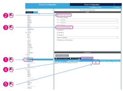

Hello @majd_sleem
In order to enable STM32_WPAN, you need to activate RF, RTC, RCC, IPCC, HSEM.
It seems that you did not activate RTC on your project.
Thanks.

Hello @majd_sleem
I think you should set the RTC as follow:
Best Regards.
