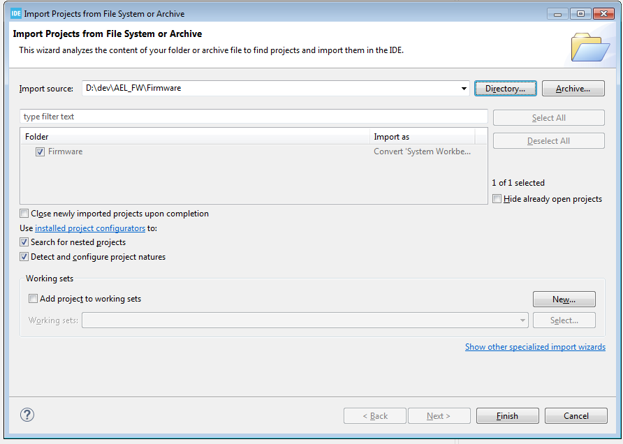

About switching to CubeIDE, I actually tried but using "File >Import... > Import ac6 System Workbench for STM32 Project" just doesn't do anything (the project explorer stays empty)
Using "Files > Open project from file system" does the same.
Which is weird because the project is actually detected : 0693W00000BZrRYQA1.png
The only thing I managed to do was to go "File > Import > Existing project into workspace" which actually imported the project, but then the build configurations are lost...
