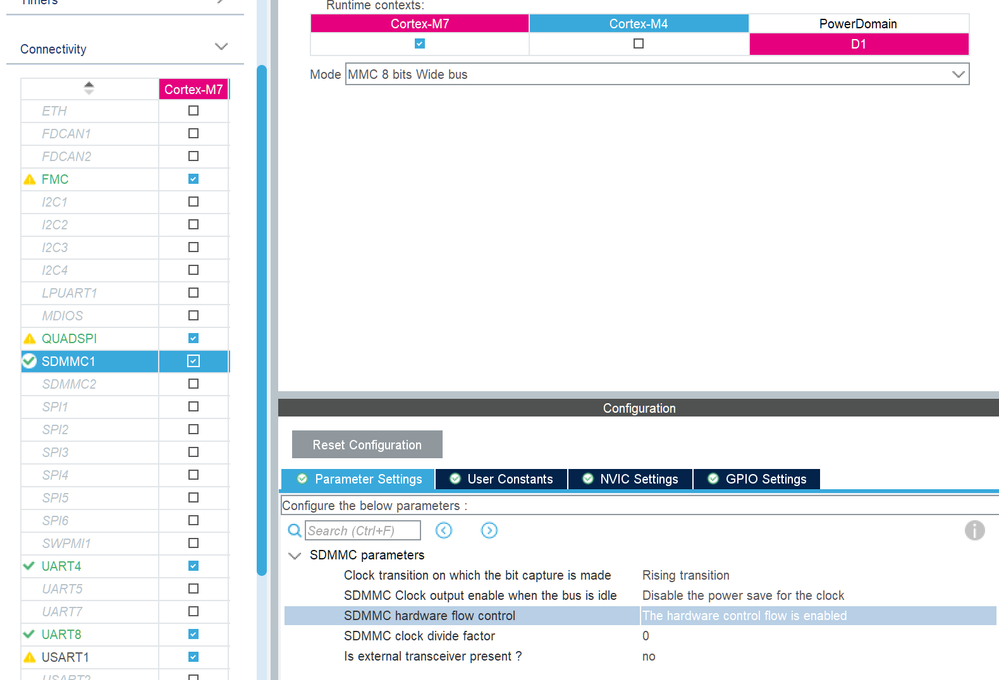

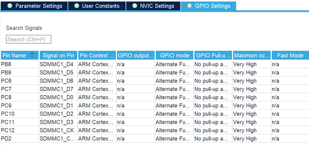

I have SDMMC1 configured for my H7 as follows:
0693W00000NrcZCQAZ.png0693W00000NrcZRQAZ.pngThe card is inserted. I call generated init, and set debug to the HAL_MMC_InitCard of stm32h7xx_hal_mmc.c file, line:

The specific hardware is STM32H747I-DISCO board. I also tested it with hardware flow control disabled. Same result.
 I switched the configuration to SDMMC_BUS_WIDE_1B and it works. At least it passes the initialization. I don't know how to interpret this behavior.
With the previous configuration you can see the QUADSPI module has a warning. The details say that some features are unavailable, but well, since they are not used (at least by me) - that should be fine, or that may be the cause of the problem?

OK, I figured out that it's for MMC cards that are completely different beasts. I have a SD card here ;)
