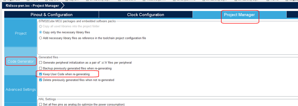

When we change the ioc file in STM32CubeIDE, there is some code that We don't want to be overwritten by the automatic generation. How can we avoid this?
Specifically, We have changed the value of HAL_StatusTypeDef in stm32f4xx_hal_def.h as follows. We don't want this to be overwritten.
That's what the USER CODE sections are for - see this thread, for example:
https://community.st.com/t5/stm32cubeide-mcus/code-generation-would-clear-my-code-in-main-c/m-p/720044
See also:
https://www.st.com/resource/en/user_manual/um1718-stm32cubemx-for-stm32-configuration-and-initialization-c-code-generation-stmicroelectronics.pdf#page=468
and make sure that you have 'Keep user code when re-generating' selected:

mƎALLEm
Hello @pass3master,
@pass3master wrote:
typedef enum
HAL_OK = 0x01U,
HAL_ERROR = 0x02U,
HAL_BUSY = 0x04U,
HAL_TIMEOUT = 0x08U
} HAL_StatusTypeDef;
This is a part of the HAL, you cannot change its definitions. May be you need to do it in your application, get the value from HAL_SPI_TransmitReceive and transform it to the value you want.
But you can add your own code between /* USER CODE BEGIN  XXX */ and /* USER CODE END XXX */
