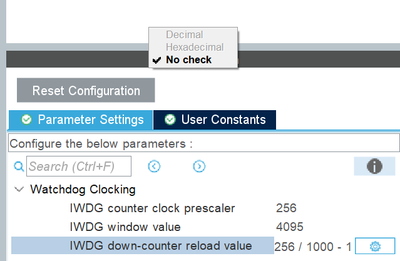

Hello, apologies if the title sounds confusing, but I wasn't sure how to accurately describe my question.
So, I have the following auto-generated code for a watchdog:

However, I want to edit line 19 as seen below:

customTimeout is a user-defined variable, which is why I don't want it to be erased whenever code is regenerated.
I am aware of the USER CODE blocks, but I don't see anyway in which I can use them. If I put line 19 in in the first 2 USER CODE blocks, they just get overwritten if I regenerate the code as there will be another "hiwdg.Init.Reload = 4095;" in the original line 19. I can't put my modified line in the third user code block, as the the watchdog would already be initialized in line 20.
Would anyone have any idea how I can overcome this issue? Thanks!

Hi @RobK1
Thanks for that, I didn't end up using that, but it helped me realise that there's this blue button here which I can click and change to "No check" so that I can input any variables or calculations inside.
Nonetheless, thank you!

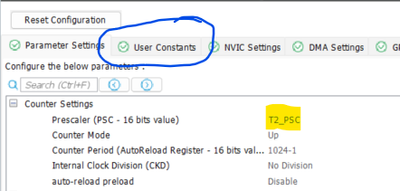

CubeMX allows you to define User Constants
is45
Hi @RobK1
And that keeps permanent? Sweet, then I learned something new as well, thanks.
is45
Yep! I was quite surprised since I didn't expect it to allow entries like that lol.
