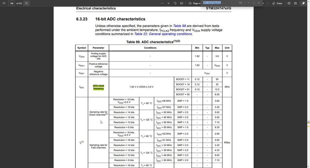

I have STM32H747-DISC1 board, and STM32CubeMX (in IDE) let me pick max. 36 MHz clock.
According to the datasheet STM32H747xI/G datasheet, ADC clock frequency get up to 50 MHz. I overriden frequency on ADC, and it works fine, so I guess this is a bug.

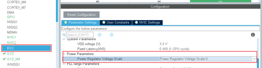

Thus, I propose a simple workaround in order to save the modification once you change Power Regulator Voltage Scale :
1- Set the Power Regulator Voltage Scale to VOS0.
2- From the File menu click on Save Project (or use Ctrl-S Keyboard shortcut)
3- From the same File menu re-Load Project (or use Ctrl-L Keyboard shortcut)

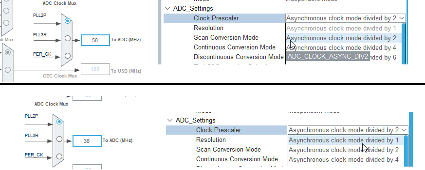

Exactly. When I set 50 MHz to ADC peripheral, in ADC configuration tab, I can pick clock prescaler only 2 and more.
When I set 36 MHz to ADC peripheral, I can set prescaler to 1. This means I can't use ADC to maximum frequency.

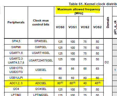

But as far as I can guess , this can be related to RCC Settings in CubeMX. In fact backing to STM32H747 Reference manual and more precisely in 9.5.8 Kernel clock selection section, Table 61 shows the kernel clock that the RCC can deliver to the peripherals:
Please check the Power Regulator Voltage Scale in CubeMX:
