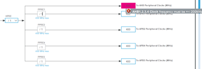

On STM32CubeMX 6.16, STM32N6 package 1.3.0, APB frequency limit is shown as 400MHz instead of 200MHz.
AHB is correctly shown as 200MHz

Hi Souhaib,
I've selected NUCLEO-N657X0-Q board, MCU should be STM32N657X0.

Thank you for bringing this issue to our attention!
The problem has been escalated to the dedicated team for fixing.  (Ticket 222493 This is an internal tracking number and is not accessible or usable by customers).
