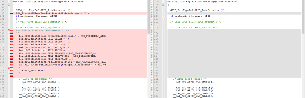

After Migrating my STM32H743ZITx project from CubeMX version 6.4.0 to 6.5.0, ADC stopped working (stucks at ADC_Calibration function).

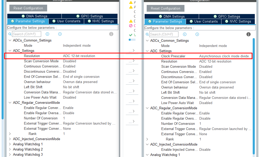

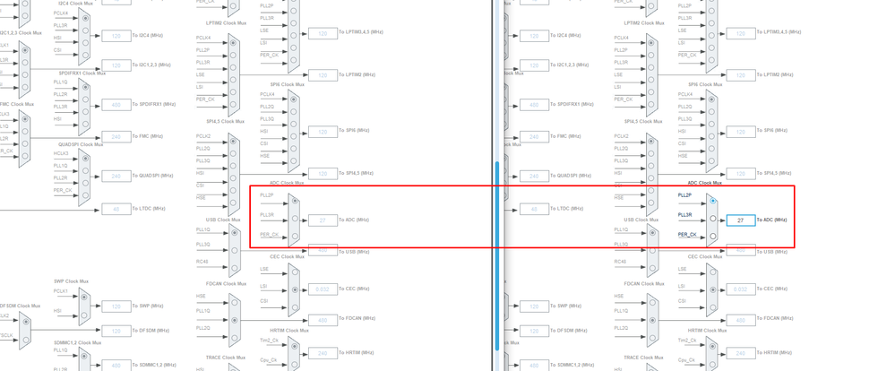

Found out that in v6.5.0 ADC Clock settings were removed for some reason.
Please see comparison below:
Also compared generated adc.c files. All Pheripheral Clock Init settings are missing.

It's a known bug. I will try to find a thread that states this.

You have two options here:
a) roll back to the previous version of CubeMX and H7FW
b) copy/paste the necessary code block for ADC from the old project if you have such
