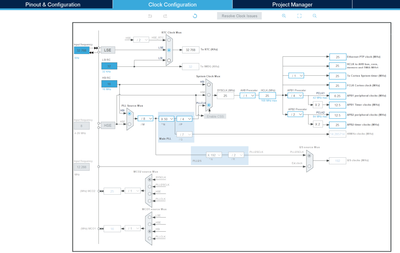

I have checked connections and assured that everything is set up correctly. When I run the below code, I cant see anything on serial console.
Does anyone have any idea about the root cause ?

I have updated the ST Link firmware and issue disappeared. I can test that UART is working, I have just written a simple code to check and I can see via serial console that UART is fine.
On the other hand, the original issue still persists.
Not sure I understand this comment. You've already succeeded to make UART working, what do you expect?
You need to start based on this working UART simple code and add step by step more code and check at each step where it fails. This is how to find and debug the issues.
I thought the original issue was that the UART didn't work?
So, if you can now see that the UART is fine, what's the remaining problem?
I still can not see any message on console printed when I run below code. I have debugged it and came to know, there is problem at SystemClock_Config(); yet I do not know what the issue, please see clock configuration in below as well.

 I have also commented out SystemClock_Config() and debugged again, this time error_handler() is called t MX_RTC_Init() function.
I suspect that, there is something wrong with my clock configuration, I just can not see what that is.
When I commented out MX_RTC_Init() function, the application runs flawlessly. Thus, after debugging I made it sure that the problem is with initialization of both system clock and RTC.
I hope I have made the topic clear, else please let me know for further information. Thanks for the support, much appreciated.

I dont read all, but primary is your code copy from ... or generated in MX right way?
Have your board LSE ?
