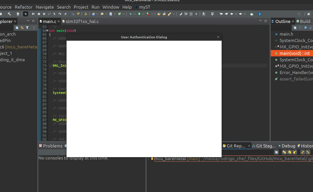

    May 14, 2024 9:05 PM UTC
    I'm having the same problem with Ubuntu 22.04. After a time with this windows authentication fail and a message to check my  conection apper, but my internet is ok. I 'm using internet wifi in my home, no proxys or not vpn's.
    What I can do?!

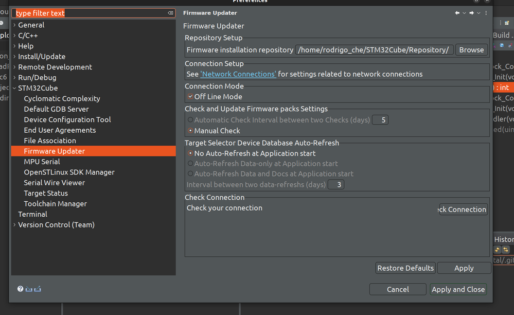

    Window-> Preferences->STM32Cube->Firmware updater
     Connection mode : check Offline mode
    Check and update... check Manual check.
    Disable anything else in the preferences that looks like automatic calling home.

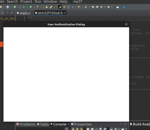

    Graduate
    May 15, 2024 1:04 PM UTC
    Nothing yet, probably something wrong with my system.

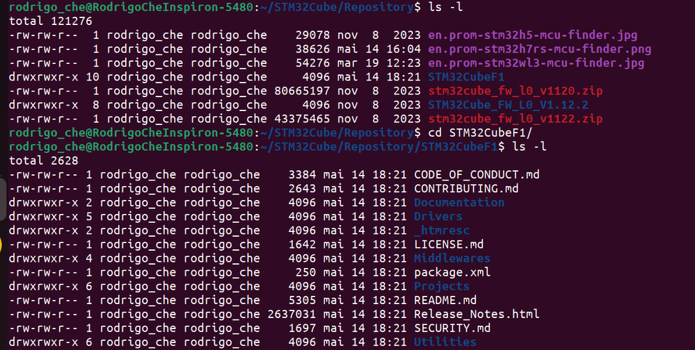

    What I did to avoid having to think too much about this problem was to clone the framework of the microcontroller I'm using, in my case the STM32F103C6TA, directly from GitHub and place it in this location in my Linux Ubuntu 22.04 system: /home/user/STM32Cube/Repository. With this, everything works fine. But the problem with logging into myST account remains the same.apagar depois.png
