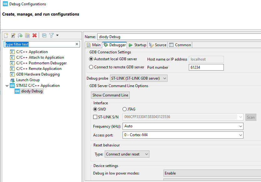

Hello, I know what the problem is but I can't solve it.
Hardware: HP Zbook G3 Workstation + HP Thunderbolt 3 dock station like thi one:
When I am connected to the station, an error occurs: No ST-link detected! Please connect ST-LINK and restart debug session. Without the docking station it works normally. The problem is the HP docking station and probably something with the ports. Has anyone encountered a similar problem and know how to solve it?

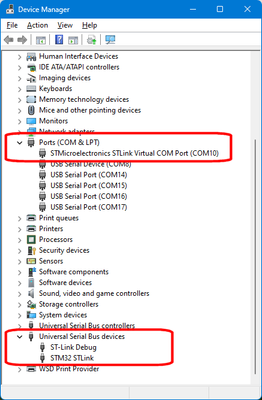

‎2024-03-04 2:31 AM - edited ‎2024-04-04 12:48 AM
Does the ST-Link appear in Device Manager?
If it's not there, then the PC can't see it - so it's never going to be detected!
#CheckDeviceManager #STLink

‎2024-03-04 2:57 AM
@rutrap wrote:it does not detect the board.
What do you mean by "it" ?
Again, does the ST-Link appear in the Device Manager?
If the PC itself isn't seeing the ST-Link (ie, it doesn't appear in the Device Manager), then no app will be able to see it.
Do you get any errors (from Windows) about "unrecognised device" or similar when you plug the ST-Link in?
‎2024-03-04 3:00 AM
Yes, the device manager detects st-link, but I don't know if it is visible in the universal serial bus as debug. I'll check it tomorrow at work. CubeIDE itself sees the board and reads the serial number correctly.

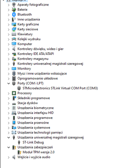

‎2024-03-05 1:13 AM
My device manager looks like this:
