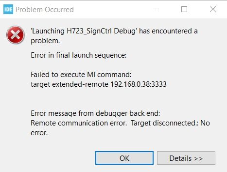

I have a Raspi4B with STlinkV3 connected and make OpenOCD run. Raspi4B connect in same subnet by WiFi.
From the log, STlinkV3 connect to target successfully as it got "Cortex-M7 r1p2 processor detected". But when I run debug in STM32CudeIDE, I got error:

Error: timed out while waiting for target halted
Error: [STM32H723ZGTx.cpu0] Execution of event gdb-attach failed:
Error: Failed to read memory at 0x5c001000
Error: auto_probe failed
Error: Connect failed. Consider setting up a gdb-attach event for the target to prepare target for GDB connect, or use 'gdb_memory_map disable'.
Error: attempted 'gdb' connection rejected
Info : Halt timed out, wake up GDB.
The config file "stlink.cfg" is mostly same. Only one line added:
bindto 0.0.0.0
to make OpenOCD can accept incoming from all network interfaces.
Stucked at this error and can not go on. Does anyone have the remote debug run?
