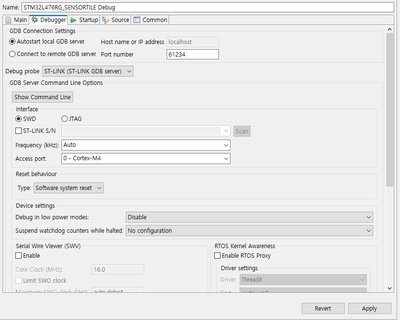

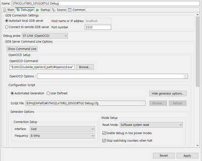

I downloaded FP-SNS-ALLMEMS2 to test sensors with STEVAL-STLKT01 and I installed STM32CubeIDE for the first time. I'm trying to test this project on STM32CubeIDE(Version: 1.17.0). But when I build and run, I get the message "No ST-LINK detected! Please connect ST-LINK and restart the debug session."
I tested both ST-LINK (OpenOCD) and ST-LINK (ST-LINK GDB server) in Debug Configuration, but they don't work. I don't know if it's a server problem or what's missing.
ST-LINK(V2, F/W: V2J42S7) is connected well in STM32CubeProgrammer.

Thanks for your reply. I have confirmed that ST-LINK is connected well with STM32CubeProgrammer by doing what you said. However, it is not connected with STM32CubeIDE.

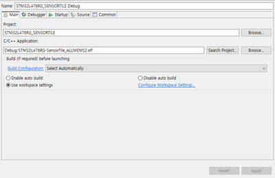

So show, what you setup in debug in IDE....
I've attached the setup below.

Try with debug option for selecting a certain st-link/SN , try: scan , to see what he can find.
You should see your st-link SN and fix it to use this.
