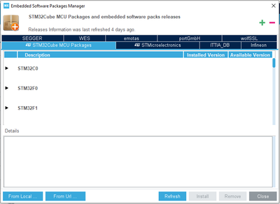

I have an H755ZL and so I downloaded CubeIDE and CubeMX to begin familiarizing myself. I am unable to install the cubeMX H7 package so I cannot generate any code for my MCU. In either CubeIDE or CubeMX when I go to "manage embedded software" nothing happens. I also cannot login as nothing happens when I click that either.

Ok not sure I understood the issue.
Do you mean when you want to select "Manage Software Packs" from "Software Packs" menu nothing happens?
In fact this window should show up:
christophersmith1618
Yes that is exactly what I mean
