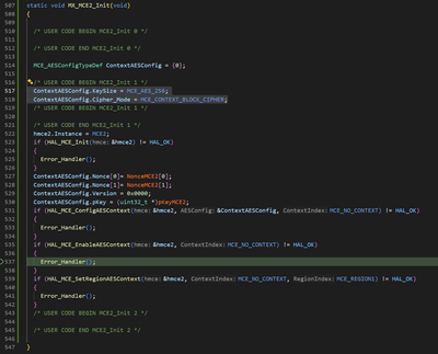

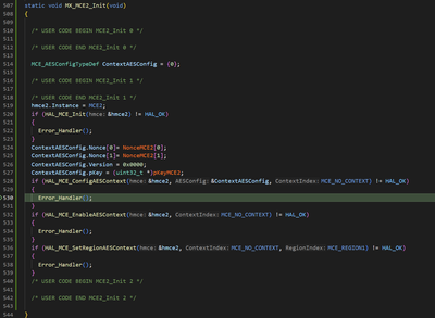

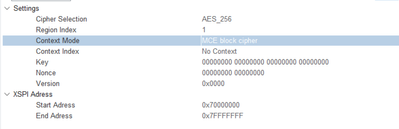

When enabling MCE2 for the STM32N6 with the following settings:
the generated MX_MCE2_Init crashes here:
 ContextAESConfig.KeySize and ContextAESConfig.Cipher_Mode are not initialized to any value. After adding:
  ContextAESConfig.KeySize = MCE_AES_256;
  ContextAESConfig.Cipher_Mode = MCE_CONTEXT_BLOCK_CIPHER;
the function crashes to:
HAL_MCE_EnableAESContext cannot be called with MCE_NO_CONTEXT.
