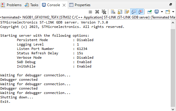

Hello!!!
I found this code in GitHub: https://github.com/ndunello/NG0B1_GFX01M2_TGFX.
I think this code could be useful for my project. When I build, no error occurs.
But when I'll record in microcontroller with debug appears that error.
Please, somebody could help me to fix this error?
This is the error log from STM32CubeIDE:
Error in final launch sequence:
Failed to execute MI command:
load C:\\Users\\Documents\\github_ndunello\\NG0B1_GFX01M2_TGFX\\Debug\\NG0B1_GFX01M2_TGFX.elf
Error message from debugger back end:
Load failed
Load failed
Load failed
Load failed
And this photo represents what shown in Console:
Solved! Go to Solution.
- Labels:
DEBUG
STM32CubeIDE
STM32G0 Series
‎2023-07-18 5:46 AM
I fixed this with myself. If someone need help with the same problem, the answer is here: I was using a code with external memory but without external memory in my hardware. So, the STM32CubeIDE cannot send the rest of pictures for memory.
To fixed this comment the external memory or make sure you have the memory in your hardware.
