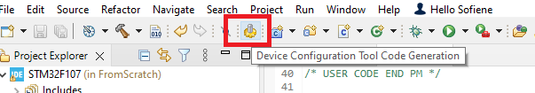

I don't know how you did start the project, I invite you to either read UM2609 / section 2.1.2 Creating a new STM32 project or simply watch one of the videos on youtube how to create a project from scratch starting from the CubeIDE. For example: https://www.youtube.com/watch?v=oJ0D5Xye6Hg.
To answer you question, and if you start your project from CubeIDE you need to click on this button to generate your code
Hope I answered your questions

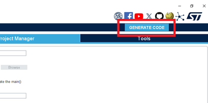

‎2024-09-26 8:02 AM
@MDe wrote:
You still do not explain me why, at some point, we need to install a second application, STM32CubeMX and generate code through it, for it to work ?
I didn't tell you at any time you "should" install STM32CubeMX.
There are two possibilities:
1- You start from CubeMx (the standalone) tool and configure your peripherals and generate your code from there. In this case you need to generate the code with this button:
2- Start from CubeIDE tool (as stated in UM2609 / section 2.1.2 Creating a new STM32 project) and use the integrated CubeMx in CubeIDE. In this case you need to generate the code with this button:
