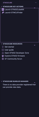

I am trying to get the VS-Code extension to work on my Intel-Mac. I already have it running on my Windows machine no problem.
The problem is, that the extensions won't activate. I have created a new project using CubeMX and choose CMake as the toolchain. Then I installed the STM32 CLI tools, as well as cmake and the ARM compiler.
Then I am opening the project in VS-Code and CMake asks for a target. I choose Debug.

But the STM Extension is stuck in activation state I think:
And I see this for a few seconds at the bottom of the window:
This is the output from the STM32Cube core extension:

Flusinerd
Fixed it by making a clean reinstall of VS-Code
